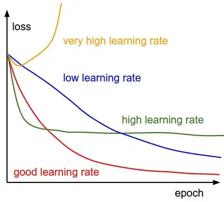

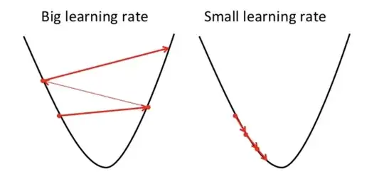

Gradient Descent is a method to find the optimum parameter of the hypothesis or minimize the cost function.
formula where alpha is learning rate
If the learning rate is high then it can overshoot the minimum and can fail to minimize the cost function. enter image description here
hence result in a higher loss.
Since Gradient descent can only find local minimum so, the lower learning rate may result in bad performance. To do so, it is better to start with the random value of the hyperparameter can increase model training time but there are advanced methods such as adaptive gradient descent can manage the training time.
