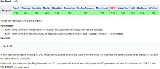

The use of G-code is probably the most simple for you to implement. The G4 command defines a "dwell" or pausing period for the next command to start:
Depending on the firmware you use, you can use the P or S parameter to specify the pausing period.
To pause the print job (for 1 hour) you need to insert the following line as the first line of your G-code print file:
G4 P3600000 // One hour pausing; defined in milliseconds
or (if your firmware supports)
G4 S3600 // One hour pausing; defined in seconds
