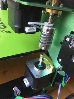

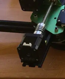

Now I have added to the suspicion the z axis coupler see images below:
z axis flexible coupling#1z axis flexible coupling#2
z axis flexible coupling#3
YouTube videos, that I have seen, show couplers that are not a spring - any thoughts? I would certainly appreciate the time anyone has to impart their knowledge.

The "springs" connected to the stepper motors aren't a problem. They are special shaft couplers which allow some relief if the motor mounts are not strictly perpendicular to the lead screws. They are very rotationally stiff and allow just a little bit of misalignment between the shafts.

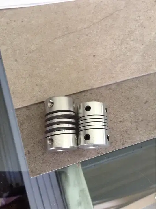

I have changed the coupler on the z axis and levelled the bed put a print on to test, skirt and first layer look good so I think we can call this one closed and thank you very much for your comments.
so over the weekend I have run a couple of prints, one very successful the other a complete fail, I would however judge the layer 1 adhesion issue to be largely solved by the replacement of the coupler, which was slightly fiddly. What I did notice was in purchasing a new coupler the design used by Tevo has to sets of perpendicular grub screws one for the lead screw and on to locate in the stepper motor shaft. The stepper motor only has in flat face so picking up on this is important and the factory had not - sloppy ! Secondly the lead screw has no faces so I dremeled two peep faces
Once the lead screw was dressed the locking down of the coupler was simple and secure. Took about 30 minutes to fix after days of misguided bed levelling and slicer tweaking.
Old and new coupler new one bought as a pair from amazon £6 could have for them cheaper but I wanted next day not to wait.
Old and new coupler

  • OK hello, so iver the weekend I have run a couple of prints, one very successful the other a complete fail, I would however judge the layer 1 adhesion issue to be largely solved by the replacement of the coupler, which was slightly fiddly. What I did notice was in purchasing a new coupler the design used by Tevo has to sets of perpendicular grub screws one for the lead screw and on to locat in the stepper motor shaft. The stepper motor only has in flat face so picking up on this is important and the factory had not - sloppy ! Secondly the lead screw has no faces so I dremeled two peep faces – ventis Jul 30 '18 at 09:11
  • Once the lead screw was dressed the locking down of the coupler was simple and secure. Took about 30 minutes to fix after days of misguided bed levelling and sliicer tweaking. – ventis Jul 30 '18 at 09:13
