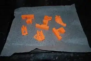

I'm in the same boat as you, was contemplating spending $2000 on a shredder, and I was inspired by this RepRap article "Plastic Shredder using Kitchen Blender".
In which someone cleverly reminds us that thermoplastics melt. Put them on a baking tray on baking paper:

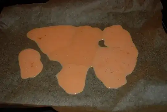

Melt them in the oven at a high temperature until they're pancakes:
The link puts them in a kitchen blender, but I've had success with a $70 micro-cut paper shredder from a local office supply store. The plastic puddles have a thin edge, which helps them fit into a shredder rated for "5 sheets of A4 at a time" (suggesting 0.3 mm max) but can process about 2 mm thick plastic if it gets a good lead-in.
The micro-cut particles it puts out are smaller than the PLA beads. I do mix recycled and virgin plastic together in varying ratios but mixing them evenly (especially with the dye beads) is tricky - it's very hard to get precise even colouring.
At 1.25 g/cc, 1 kg of PLA in an oven dish ~A4 sized is about 1.4 cm thick. So, aiming for about 100 g of plastic per dish will get you blobs averaging 1.4 mm. That fits through the shredder fine. 10 blobs make 1 kg of filament.
The only issue I have with the cheap office shredder is when you feed something slightly too thick in, occasionally the teeth deform the plastic into a chunk too big to fit into the shredder for a second pass, so that piece needs to go back into the melt queue.
