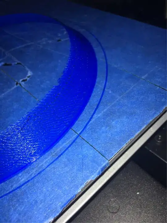

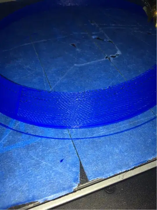

It's my first time printing in vase mode, and I noticed my printer underextruding badly. The settings have not been changed from default vase mode settings in slicer, and earlier I was printing non-vase mode and the prints came out fine. Layer height is 0.2 mm and perimeter width is 0.3 mm.
Did you check for the most obvious reasons like friction on filament unrolling, clogging, layer height, etc. – 0scar Mar 26 '18 at 05:10
@0scar Yes, I stopped the print and used manual control to extrude filament. It came out completely straight and normal looking. Layer height is set to .2. – patrick jackson Mar 26 '18 at 05:12
PLease let your print run for at least 10 layers so we can see what happens when the system gets away from the bed. – Carl Witthoft Mar 26 '18 at 12:45
1It looks as there are more than 10 layers already. – 0scar Mar 26 '18 at 20:53

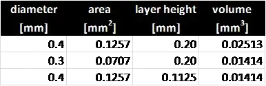

To support this, the next table shows the volume calculation for the filament (based on extruded cilinder shape), the first row is the volume you need to fill the 0.2 mm layer height (0.025 cubic mm), the second is what you extrude with a 0.3 mm width for a 0.2 mm layer (0.014 cubic mm). From this latter value you can calculate the layer height for a 0.4 mm diameter nozzle to be about 0.11 mm, clearly not filling the gap.

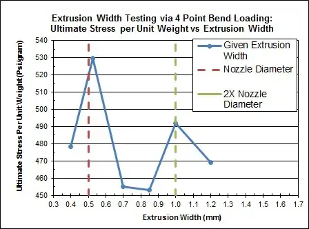

The extrusion width versus strength show the optimum strength when the nozzle extrusion width equals the nozzle size.

I'm almost 100% positive the problem comes from somewhere in slicer. Before the vase mode print, my extruder worked perfectly and I was able flawlessly print some models. During the vase mode print I even stopped it and used manual controls to manually push material through the hot end, which worked perfectly. – patrick jackson Mar 26 '18 at 14:24
What is the size of the nozzle? E.g. printing 0.3 with a 0.4 nozzle is not optimal. – 0scar Mar 26 '18 at 15:02
@patrickjackson I have updated the answer for you, I strongly suspect that your volume flow is not enough (so indeed a slicer setting as you suspected) – 0scar Jun 04 '18 at 07:02
