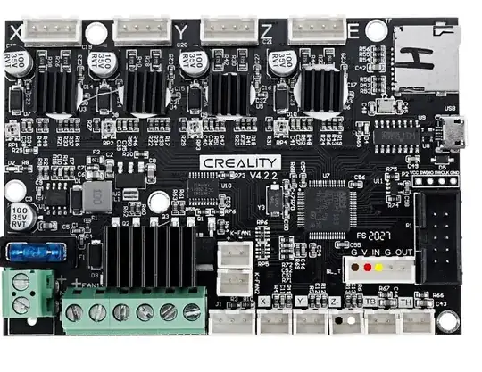

I bought an Ender 3 recently and it has the 4.2.2 Creality board. Then I bought a BLTouch to upgrade it with bed leveling. It turns out that the BLTouch now comes with a standard 5-pin connector instead of the separate wires that all the tutorials talk about. How do I install the thing?
2 Answers
The BLTouch now comes with a standard 5-pin connector.
and that connector is supported on the board that seems to be shipping with Ender 3s these days, the Creality 4.2.2 board (Notice it's in the bottom right and says BL_T next to it)

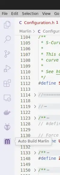

Now we need Visual Studio Code (told you you get to be a developer). Once you open it, you'll need to install an extension Marlin made for VSCode to allow you to easily build your firmware. The instructions on installing Auto Build Marlin are found here.
Now you have a neat little button in VSCode to do stuff with Marlin.
