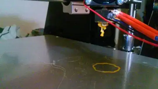

I am using the E3D v6 hotend with the titan extruder. Everytime I go to do a test print, just enough stringy filament oozes comes out of the hotend "right before" it lays down the first layer. I have no idea why it oozes out the little bit of filament before it prints.... The unwanted filament builds up while some of the first layer is done. As a result, what has been printed or about to be printed get stuck together as it tries to do the rest of the print....
Hi, Chris! What filament and temperature are you printing at? FYI, this is common for bowden pinters: my bowden printer also oozes as the hotend heats up due to the *hystiresis* (or "spring effect") of the bowden tube. I do not know if the Titan extruder could be susceptible to this since it isn't (?) bowden. – Tormod Haugene Jun 29 '16 at 05:47
Maybe you could post your start G-code (and a bit of the first layer) so we can see what your printer is actually doing. – Tom van der Zanden Jun 29 '16 at 07:14
Hmm, just to be sure, do you mean the plastic is oozing from the tip of the nozzle (normal) or is oozing out from between the nozzle and hot block? – Ryan Carlyle Jun 29 '16 at 14:15
