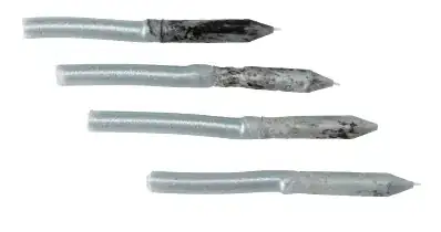

The above image resembles my experience, although the severely "dirty" image is much more excessive than my cleanings. The worst is to have PVA support material that has been "cooked" at ABS temperatures or higher for long periods. An almost guaranteed nozzle clog is the result of those conditions.

That's black filament residue, not carbonized filament afaict. Looks like when I accidentally loaded the wrong color and immediately pulled it out after loading. – Trish Dec 15 '19 at 09:46
