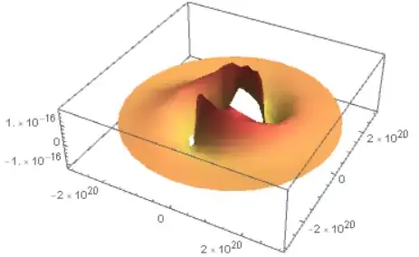

Side view of the density graph.

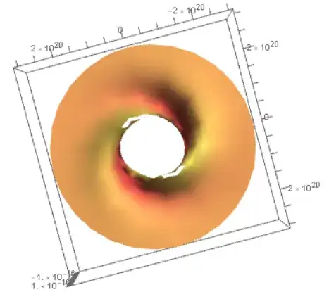

Top view of the density graph.
The spiral structure should be quite evident here. However, there are two perturbing details. The first is that there is explosive growth near the center. I’ve deliberately truncated the inner radius to $3\text{ kpc}$, which is where the spiral structure really starts. A different density profile is needed there. At radii similar to the Sun’s orbital radius, our density profile is sufficient. Eventually, at large enough $R$, $\rho$ actually becomes less than zero, but we should treat that as an unphysical result and assume that the profile is truncated once $\rho=0$. This happens around $\sim8\text{ kpc}$, indicating that we need to add a value for $m=0$. The exact fitting for that can be handwaved a little, but in the spiral arms, it appears that the results match local mean densities to within a few orders of magnitude ($\sim10^{-18}\text{-}10^{-20}\text{ kg/m}^3$, which isn’t too bad).
Let’s say, then, that we add this $m=0$ term to avoid negative densities. If we want $\rho>0$ out to about $12\text{ kpc}$, then we need it to be around $\sim2.45\times10^{-18}\text{ kg/m}^3$. Again, at smaller radii, this will produce larger-than-usual densities, but it is necessary to avoid unphysical results.
