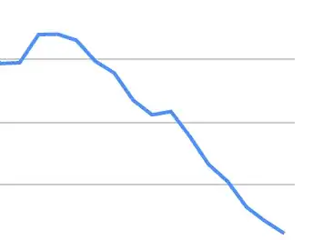

Currently we will keep the old sitemap for one month from the time of the switch. We can already see a decline in the number of clicks on the HTTP property, and a proportional increase in the number of clicks in the HTTPS property.
Here's what you should see:
Our Search traffic declining on the HTTP property.
Our Search traffic increasing on the HTTPS property.

  • What do you see for the "number of indexed pages" in Google Search Console? Would you say the total (HTTP + HTTPS) has remained about the same? (Which your search traffic graphs would seem to suggest.) – MrWhite Mar 04 '16 at 15:47
    Yes it's definitely not gone down. It's about the same. – CP3O Mar 04 '16 at 16:46
