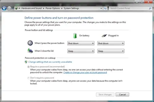

I have tried: Checking the power settings. I have it set to sleep when I close the laptop lid regardless of whether I'm on battery power or plugged in. Windows power settings

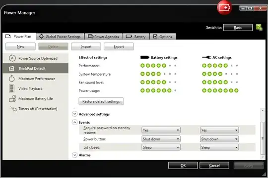

Checking Lenovo's power control panel (which should be reflected in Windows' own settings anyway). Lenovo power settings

There is another setting you could check.
other close lid options
See Control Panel => Hardware and Sound => Power Options => Edit Plan Settings and from there Change advanced power settings => Power buttons and lid.

  • Yes, those were both set to "Do nothing". Changing it doesn't seem to take, probably because of the Lenovo Power Manager. Changed it to "sleep" and it now does so. (Why the heck would it have two conflicting options like that?)
    Changing it didn't take. I found there was similarly the same setting in Lenovo's Power Manager, under Global Settings. I made sure it was set there and disabled Enable InstantResume and now it works! Thanks for the help!

I found the solution. Like @ott--'s answer stated, there is another setting hidden that can potentially contradict the settings I checked below (oddly enough). They didn't take because the Lenovo Power Manager takes precedence. I found this under the Global Settings tab, which similarly can contradict and I suppose override whatever the individual plans say. Lenovo Power Manager Global Settings
I had it set to sleep on lid close, but the option called "Enable InstantResume" was checked, which I suppose held it off from going to full standby. I unchecked that option and now it's going to standby as expected!
