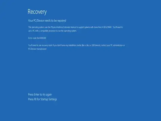

    If the status of Hyper-V is this or this, I get the following error when I start simulating Windows 10 Technical Preview:
    However, if I enable Hyper-V, I get the following error:
    If I hit Continue, the following error comes:
I still cannot use 64-bit operating systems:

By installing Hyper-V on step 3, the OP inadvertently installed a bare-metal hypervisor onto the machine. For hardware virtualization to work, the hypervisor is required to take hold of a specific feature on the CPU, either Intel VT-x or AMD-V. Only one hypervisor can control this feature at a time. In addition, a bare-metal hypervisor is in control of this feature every time the machine starts up.
For this reason you may not run more than one of the following at one time (with all feature, or at all)
  • Hyper-V*
  • Parallels Workstation
  • QEMU
  • VirtualBox
  • Virtual PC
  • VMware ESXi*
  • VMware Workstation
  • VMware Workstation Player
  • Windows Defender Application Guard*
  • Any other hypervisor that uses hardware virtualization
Items marked with * are bare-metal hypervisors.
The solution is to either uninstall Hyper-V or use Hyper-V instead of VirtualBox.
I would advise you to do the last option, as Hyper-V will be much better tested with Windows 10 preview than VirtualBox will have been.
