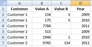

I have a data dump in Excel that consists of annual customer data for two different values. The data was provided with a separate row for value for every year and customer. I.e. it looks like this:
I'm stuck with a row for Customer 1 for Value A in 2009 and a separate row for Value B for the same customer in the same year.
In some instances there is no Value A or Value B. In the example above, you can see that Customer 1 has no Value B in 2011, so no row was generated for that. And, though not represented in the example, some clients will have no data for either value in a year (and thus no row for that customer in that year). In that situation, lacking a row for that customer in that year is fine.
I want to get this into a worksheet where there's one row for both values for every year and customer. I.e., I want the data to look like this:
What is the most effective way to create that result?

This is VBA, or a macro you can run on your sheet. You must hit alt+F11 to bring up the Visual Basic for Application prompt, go to your workbook and right click - insert - module and paste this code in there. You can then run the module from within VBA by pressing F5. This macro is named "test"

This will run through a sorted spreadsheet and combine consecutive rows that match both the customer and the year and delete the now empty row. The spreadsheet must be sorted the way you've presented it, customers and years ascending, this particular macro won't look beyond consecutive rows.

Everyone is using a lot of VBA code or complicated functions for this. I have a method which takes a second to implement but is far more understandable and very easy to adjust depending on various other possibilities.
In the example you've given above, paste these (4) functions into the cells, E2, F2, G2 and H2, respectively (the F&G functions reference cells above):
=IF(D2=D3, A2,         IF(D2<>D1, A2,            ""))
=IF(D2=D3, MAX(B2:B3), IF(D2<>D1, B2,            ""))
=IF(D2=D3, MAX(B2:B3), IF(D2<>D1, IF(C2=0,"",C2),""))
=IF(D2=D3, D2,         IF(D2<>D1, D2,            ""))
Drag these formulae as far down as necessary. It generates a single row of data each time 2 rows are present, leaving single rows unaffected. Paste special the values (to remove the formulas) of columns E-F-G-H elsewhere and sort them by customer to remove all the extra rows.

Here are steps for creating a separate table with the condensed data.
  1. Copy your entire table and paste it on a new sheet.
  2. Select your new table and Remove Duplicates (Data ribbon -> Remove Duplicates) on columns Customer and Year. This will provide the framework for the condensed table.
  3. In B2 (the first entry for Value A) enter the following:
    =IFERROR(INDEX(Sheet1!B$1:B$11,MIN(IF(Sheet1!$A$1:$A$11=$A2,IF(Sheet1!$D$1:$D$11=$D2,IF(Sheet1!B$1:B$11<>"",ROW(Sheet1!$A$1:$A$11),1000000),1000000),1000000))),"")
    Enter the formula as an array formula by pressing Ctrl+Shift+Enter.
  4. Fill the formula down the column. Then fill over to fill the Value B column as well. Voila!
