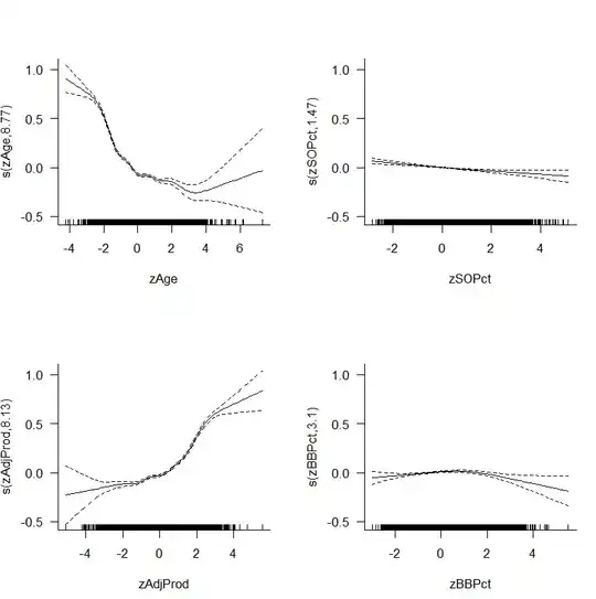

Following the advice in a previous thread, I tried a Box-Cox transformation with no success. Next, I tried a GAM with a log link and received these plots:
splines
Original diagnosticChecksGAM
New Diagnostic Plot GAMDiag
It looks like the splines helped fit the data but the diagnostic plots still show a poor fit. EDIT: I thought I was looking at the residuals vs fitted values originally but I was incorrect. The plot that was originally shown is marked as Original (above) and the plot I uploaded afterwards is marked as New Diagnostic Plot (also above)

  • Why do you think the output of gam.check() is not promising? Non of the p-values indicates significant pattern related to too-low dimensionality in the basis functions used. – Gavin Simpson Jun 14 '13 at 02:36
