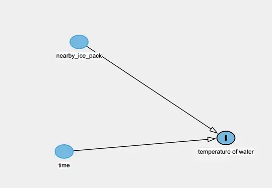

I see no problem with this. A simple example from physics: suppose you are interested in modelling the DAG of the temperature of a glass of water. It might look something like:
Time does cause the temperature to change. There are mediators in between, but it doesn't matter from this 10,000 foot view. From this DAG, it is logical to include time as a variable in a regression model, as expected.
When I was drawing this, I was thinking "are there any interesting confounders of time and temp I could include?" - but no, because nothing, AFAIK, causes time.
Turning to the question of interpretation, that's trickier and it might come down to whether you follow Hernan's "no causation without manipulation" vs Pearl's "anything goes" attitude. See some of their recent papers on the topic including Does obesity shorten life? and Does Obesity Shorten Life? Or is it the Soda? On Non-manipulable Causes.
    This is a good example. Atomic decay is another one from physics where time is a useful parameter. I personally argue that in other disciplines and domains (e.g., epidemiology, ecology, economics, etc.) including time as an 'explanatory' variable is hand-waving past a causal model of the dependent variable (see comment exchange). – Alexis Dec 30 '19 at 04:14
    Time itself does not cause the temperature to change. Temperature is a summary statistic of kinetic energy, which is exchanged by molecules of water and the environment (it's pretty much the OG mean field approximation). Time indexes the number of micro-scale exchanges here. Calculating the causal effect of time - even if we mentally add '(index)' at the end - leads to absurd results if you try to generalize, e.g. you'd expect water in the fridge to cool at the same rate as water in an oven. – jkm Dec 30 '19 at 11:49

    The point about calculation and generalization is a statistical / estimation concern - that should be separated from the DAG / causal concerns. If the problem is with time not causing temperature to change, then feel free to substitute "kinetic energy" in place of "temperature". – Cam.Davidson.Pilon Dec 30 '19 at 16:41
  • My point was that time doesn't cause kinetic energy to change, either. Collisions are the real cause here, and are something you can absolutely apply do-calculus to and get coherent results (trivially - put the ice and the water in vacuum flasks, for example). Time acts only as the exponent of a functional power over the actual functor you can reason about in causal terms. – jkm Dec 30 '19 at 17:34
  • I agree that time can be a variable but he answer and motivation here is wrong. @Cam.Davidson.Pilon has the wrong definition of causality. – Hunaphu Dec 30 '19 at 18:23
  • @jkm I need to dissect your last statement more. From your description though, I could put "collisions" as a mediator - as silly as it may sound, if I wiggle time, then I wiggle the rate of collisions, no? – Cam.Davidson.Pilon Dec 30 '19 at 20:45
