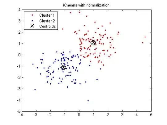

K-means:
K-means clustering is "isotropic" in all directions of space and therefore tends to produce more or less round (rather than elongated) clusters. In this situation leaving variances unequal is equivalent to putting more weight on variables with smaller variance.
Example in Matlab:
X = [randn(100,2)+ones(100,2);...
     randn(100,2)-ones(100,2)];
% Introduce denormalization
% X(:, 2) = X(:, 2) * 1000 + 500;
opts = statset('Display','final');
[idx,ctrs] = kmeans(X,2,...
                    'Distance','city',...
                    'Replicates',5,...
                    'Options',opts);
plot(X(idx==1,1),X(idx==1,2),'r.','MarkerSize',12)
hold on
plot(X(idx==2,1),X(idx==2,2),'b.','MarkerSize',12)
plot(ctrs(:,1),ctrs(:,2),'kx',...
     'MarkerSize',12,'LineWidth',2)
plot(ctrs(:,1),ctrs(:,2),'ko',...
legend('Cluster 1','Cluster 2','Centroids',...
       'Location','NW')
title('K-means with normalization')
(FYI: How can I detect if my dataset is clustered or unclustered (i.e. forming one single cluster)
