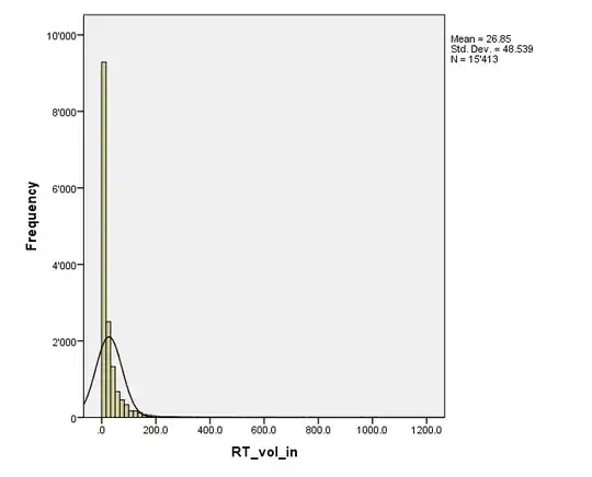

In a multiple regression with 16k cases 2 IV (non-normally distributed) and one dependent variable that is also not normally distributed. DV see below:
enter image description hereenter image description here
I've tried three ways of transforming the DV (sqrt/ln/log) to normal but the K-S statistic reports it clearly as non-normal .
The best I could come up with was the ln or log transformation, which clearly shows a trend in the detrended qq plot. Any ideas how to "fine-tune" the ln transformation to remove that trend?

    In OLS regression neither the IV nor the DV has to be normally distributed, only the residuals do. So, first thing is to check that, which your last histogram does. It looks fairly normal. – Peter Flom Jul 31 '12 at 10:56
    but i thought that having normally distributed variables improves the estimator, doesn't it? – plotti Jul 31 '12 at 11:25
To clarify what Peter Flom's point is, if you have normal residuals in a regression model and the model is adequate the DV or response variable y will be normally distributed but with mean equal to the regression function ax+b where x is your IV. How x is distributed depends on your design. If you do a histogram of the ys it doesn't tell you anything useful becuase it is just a mixing of normal distributions with different mean values. Histograms of the estimated residuals and qq plots of the residuals can help you determine whether or not the normality assumption is violated to the extent that you need to do something about it. Transformations that make the residuals look more like thay are normally distributed is one way to deal with the problem if you have it. But the are alternatives that I think are better. Robust regression and bootstrap are two such alternatives that I prefer.
Now Peter is right. Your residual histogram looks reasonably normal, so there is probably no need for a transformation or any other change in the model or the fitting procedure.
    by " so there is probably no need for a transformation or any other change in the model " do you mean there is no need for an ADDITIONAL transformation or should I compute the model with the non-transformed IVs and DV? – plotti Jul 31 '12 at 12:57
    The model in the final histogram (which seems like the only plot that has residuals graphed) looks fine. – Peter Flom Aug 01 '12 at 10:50
