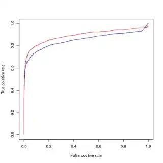

PR for unbalanced training ROC for unbalanced training

PR for balanced training, visualised on balanced dataset ROC for balanced training, visualised on balanced dataset

PR for balanced training, visualised on original, unbalanced dataset ROC for balanced training, visualised on original, unbalanced dataset

  1. Is the reason the visualization of the PR curve shows inferior performance of my trained model (red), while ROC curve shows improvements because of the class imbalance?

I wanted to draw attention to the fact, that the last 2 experiments are in fact using the SAME model on ALMOST THE SAME dataset. The difference in performance is not model difference, it is explained by different distributions of validation dataset and the properties of particular METRICS used - precision and recall, that depend highly on that distribution. To elaborate this point a bit more, if you took X distinct entries from your initial validation dataset and replicated the minority class for the upscaled dataset, your model will make the same predictions for those X entries, correct or incorrect, in both upscaled and unbalanced validation datasets. The only difference is that for each false positive there will be less true positives in the initial dataset (hence lower precision) and more true positives in the balanced dataset (simply due to the fact that there are more positive examples in the dataset in general). This is why Precision and Recall are said to be sensitive to skew. On the other hand, as your experiments illustrate as well, ROC does not change. This can be observed by looking at its definition as well. That's why ROC is said to not be sensitive to skew.

In regard to ROC curves, ROC curves are known to show little effect from class distribution variations (upscaling has very minor effect on FPR, while you can see some effect on TPR).
