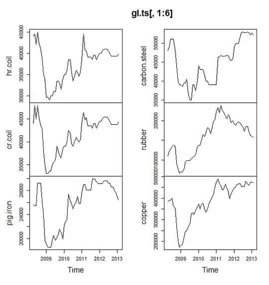

Attaching the timeseries plot and data enter image description here

EDIT 2: One question, can you please tell me if my data has any seasonality or trend? And also please give me some tips on how to identify them. enter image description here enter image description here
    If you're looking at trying to forecast groups of commodities, such as various types of metal (steel A, steel B, steel C, etc.), then it might be worth testing for the existence of cointegration. For example, something like this: Do steel prices move together?. This may provide better 6 month (medium/long term) forecasts than univariate methods, but this is, indeed, a difficult game that you're trying to play. ;-) – Graeme Walsh Mar 04 '15 at 01:06
    AS @GraemeWalsh points out, univariate trend extrapolation might not be ideal for this type of data. There are well established methods in the literature for forecasting oil, steel prices that might be worth exploring. – forecaster Mar 04 '15 at 16:00
    Can you post new edits as a separate question ? Since you have already accepted an answer the new questions might not get the attention it needs. From eyeballing the data I can say none of them have trends or seasonal patterns. As noted in my post below, looks like the downward trend before 2009 is a macro economic phenomena like recession ? – forecaster Mar 04 '15 at 21:19
  • @forecaster,@GraemeWalsh : Thank you. I am planning to use cointegration method using ADF tests. – Niranjan Sonachalam Mar 04 '15 at 21:19
  • @forecaster: I have created a separate question, here is the link http://stats.stackexchange.com/questions/140369/timeseries-forecasting-cointegration – Niranjan Sonachalam Mar 04 '15 at 21:44
    You have provided context in your new question and it makes mosre sense now. So drop prior to 2009 was indeed some macro economic phenomena. In that instance please use random walk method with drift or (arima(0,1,0)+drift – forecaster Mar 04 '15 at 22:25

It actually looks like arima is one of the worst models you could chose for this training and test set.
I saved your data to a file call coil.csv, loaded it into R, and split it into a training and test set:

Tellingly, the exponential smoothing model is always picking the naive model (the orange line and blue line overlap 100%). In other words, the naive forecast of "next month's coil prices will be the same as this month's coil prices" is more accurate (at almost every forecast horizon) than 7 extremely sophisticated time series models. Unless you have some secret information the coil market doesn't already know, beating the naive coil price forecast is going to be extremely difficult.
It's never the answer anyone wants to hear, but if forecast accuracy is your goal, you should use the most accurate model. Use the naive model.

  • Thanks a lot, but I am not getting good forecasts for the above dataset (I think I am missing some important step here). Can you please let me know if I am missing something – Niranjan Sonachalam Mar 04 '15 at 00:28
  • @Niranjan Can you tell us/show how you conclude that you are not getting good forecast? – forecaster Mar 04 '15 at 00:32
  • @forecaster: Please check here http://pbrd.co/1DRPRsq . I am new to forecasting. Let me know if you need any specific info. I tried with Arima model. – Niranjan Sonachalam Mar 04 '15 at 00:41
  • @Niranjan See my new edits. Your dataset doesn't have an obvious trend or seasonal pattern: it's probably a random walk, which makes it very hard to forecast. Also, it's dangerous to choose a model based on a single test set =D. – Zach Mar 04 '15 at 16:30
  • @Zach Very nice I wish I had R skill like yours. ARIMA will be the most accurate model if you use ALL the data for model because auto.arima picked random walk (aka) naive with drift which is recommended for these type of problems. I'm not sure why in your cross validation, ARIMA turned out to be least accurate, May be CV is not appropriate for such short patternless time series. – forecaster Mar 04 '15 at 20:59

          33500, 34500, 36000, 35500, 34500, 35500, 38500, 44500, 40700,
          40500, 39100, 39100, 39100, 38600, 39500, 39500, 38500, 39500,
          40000, 40000, 40500, 41000, 41000, 41000, 40500, 40000, 39300,
          39300, 39300, 39300, 39300, 39800)
coilts <- ts(coil,start=c(2008,4),frequency=12)
library("forecast")
# Data for modeling
coilts.mod <- window(coilts,end = c(2012,3))
#Data for testing
coil.test <- window(coilts,start=c(2012,4))
# Model using multiple methods - arima, expo smooth, theta, random walk, structural time series
#arima
coil.arima <- forecast(auto.arima(coilts.mod),h=11)
#exponential smoothing
coil.ets <- forecast(ets(coilts.mod),h=11)
#theta
coil.tht <- thetaf(coilts.mod, h=11)
#random walk
coil.rwf <- rwf(coilts.mod, h=11)
#structts
coil.struc <- forecast(StructTS(coilts.mod),h=11)
##accuracy
arm.acc <- accuracy(coil.arima,coil.test)
ets.acc <- accuracy(coil.ets,coil.test)
tht.acc <- accuracy(coil.tht,coil.test)
rwf.acc <- accuracy(coil.rwf,coil.test)
str.acc <- accuracy(coil.struc,coil.test)
Using MAE on the hold out data, I would choose ARIMA for short term forecast (1 - 12 months). for long term, I would rely on random walk forecast. Please note that ARIMA picked a random walk model with drift (0,1,0)+drift which tends to be much more accurate than pure random walk model in these type of problems specifically short term. See below chart. This is based on the accuracy function as shown in the above code.
Specific answers to your specific questions: Also one question I had was, before passing to ARIMA or neural net should I smooth the data? If yes, using what?
  • No, Forecasting methods naturally smooths your data to fit model.
The data shows both Seasonality and trend.
  • The above data doesnt show trend or seasonality. If you determine that the data exhibits seasonality and trend, then choose an appropriate method.
Practical Tips to improve accuracy:
Combine variety of forecasting methods: - You could try using non extrapolation methods such as forecasting by analogy, judgmental forecasting or other techniques and combine them with your statitical methods to provide accurate predictions. See this article for benefits of combining. I tried combining the above 5 methods, but the prediction were not accurate as individual methods, one possible reason is that individual forecast are similar. You reap the benefits of combining forecast when you combine diverse methods such as statistical and judgmental forecasts.
Detect and Understand Outliers: - Real world data is filled with outliers. Identify and appropriately treat outliers in time series. Recommend reading this post. In looking at your coil data, is the drop prior to 2009 is an outlier ??
Edit
The data appears to be following some type of macro economic trends. My guess is the downward trend seen before 2009 follows slump in economy seen between 2008 - 2009 and start to pick up post 2009. If this is the case, then I would all together avoid using any extrapolation methods and instead rely on sound theory on how these economic trends behave such as the one referenced by @GraemeWalsh.
Hope this helps
forecaster
  • 8,145
