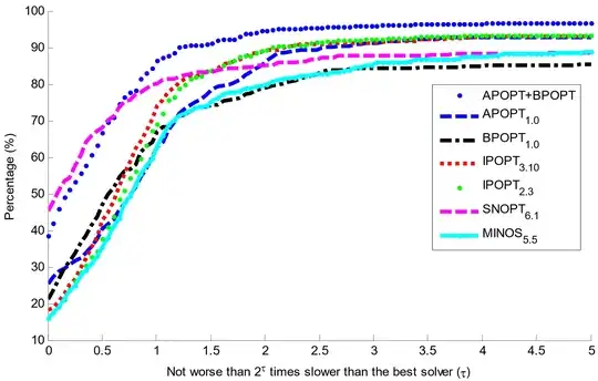

APOPT is another NLP (and MINLP) solver that works with Pyomo by reading .nl files and producing .sol files. The solver is apopt.py and called with Python to send the .nl file to a compute server and then return the .sol file back to Python and returned to Pyomo. Here is the source code on GitHub with instructions on use. Please note that we are still developing this solver and I'd appreciate any feedback on the performance. Here are some benchmark results that we shared in 2012 at INFORMS.
NLP Benchmark Results
    Thanks John. I see APOPT is sending the mathematical program file to the server, and sending results back. In case I want own architecture, cloud deployment, many instances running in parallel etc. or I have confidential models/parameters, I would need a local version. Is there such arrangement? Do you plan to have APOPT as a truly open source solver, or you want later on to make it a commercial solver? What is "behind the hood" behind APOPT - i.e. what kind of method is behind it? – Stanny_boy Aug 18 '19 at 13:59
  • APOPT is freely available with Python Gekko and APMonitor. It is included with the local executables here: https://github.com/BYU-PRISM/GEKKO/tree/master/gekko/bin For pyomo / AMPL, I run the web-service with the stand-alone APOPT to collect benchmark problems that further improve the solver. While it is under development, this is very valuable to have cases to improve the solver. It is an MINLP solver and I'm working on combined interior point / active-set method for the NLP. It is not ready for commercial deployment yet. – John Hedengren Aug 18 '19 at 14:08
    Many thanks John. I will surely give it a try. Would be great to know if/when you plan to have compiled or local version of the solver for pyomo. Till then i will test the web service for performance. – Stanny_boy Aug 18 '19 at 14:20
