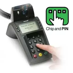

Card Reader & PIN Entry:
Chip Card Reader
Are they really better from a security point of view? What are the advantages and disadvantages?
