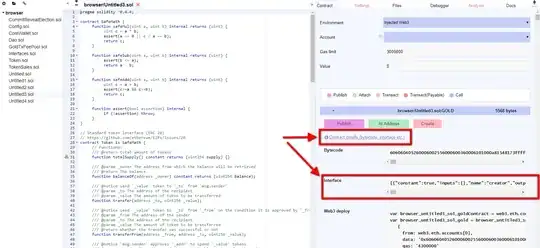

EDIT
On Compile tab (right top menu) just click on Details.
OLD METHOD
In the new version of Solidity Browser you can find Interface value clicking on Contract details (bytecode, interface etc.)
Solidity Browser Json Interface

Simple go to http://remix.ethereum.org/ and paste the source code of the contract. Click of Start compile and after a few seconds or so, your contract is processed. Click on detail button (found at the top-right). On the popup, you would find the ABI, METADATA, BYTECODE, etc
