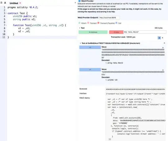

It is quite complicated to get this correct, but here's some information on how to work it out.
I'm using a simple contract as an example:
pragma solidity ^0.4.2;
contract Test { uint256 public v1; string public v2;
function Test(uint256 _v1, string _v2) {
    v1 = _v1;
    v2 = _v2;
Here is my deployment to a --dev blockchain using Browser Solidity:

Sending the Data: part above as the data: parameter in your JSON-RPC eth_sendTransaction transaction will achieve the same action of deploying the contract onto the blockchain with the same constructor arguments.
You can see the first part of the Data: field (not bolded) matching the contract bytecode, and the second part of the Data: field (bolded) represents the constructor arguments.
The constructor arguments are:
// _v1: 0x7b = 123
000000000000000000000000000000000000000000000000000000000000007b
// 0x40 = 64. This is the offset from the beginning of _v1
// directly above to the start of the next set of hex strings
// ending below
0000000000000000000000000000000000000000000000000000000000000040
// 0xd = 13 - the length of the "Hello, World!" string
000000000000000000000000000000000000000000000000000000000000000d
// In geth,
// > web3.toUtf8("48656c6c6f2c20576f726c642100000000000000000000000000000000000000")
// "Hello, World!"
