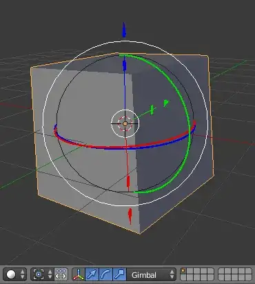

(Per ideasman42's comment): We can easily see this for any object using Euler rotational system, by manipulating the rotation widget with transformation orientation set to Gimbal. It turns out to be easy to reproduce, by manipulating 2nd axis in the evaluation order (Z for XZY, or X for ZXY, etc.). I get the following condition on XYZ order by just manipulating Y axis:
Gimbal lock on Euler with XYZ evaluation order, by manipulating Y axis.

    Suggest trying the Gimble manipulator Orientation Mode and enable Rotate, then you can see the problem that happens when 2 axis line up. – ideasman42 May 30 '13 at 12:43
    @ideasman42: That's a good demonstration tool.

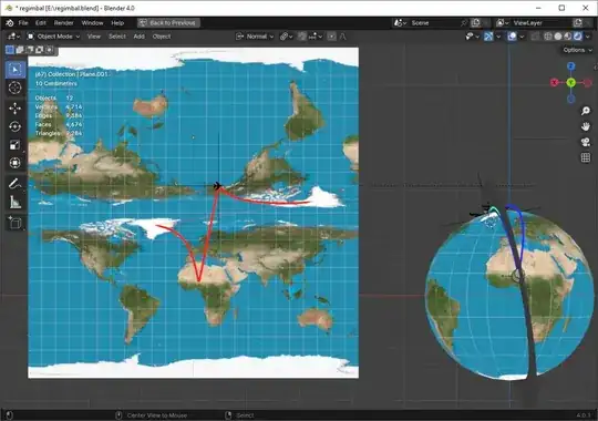

A different metaphor than gimbal lock

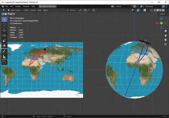

Let's imagine we're in an airplane. Most of us have been. Earth is a sphere; as we fly over its surface, we're rotating about its center in three dimensions. We want to get from one place to another. How do we get there?
Problem #1: Torque.

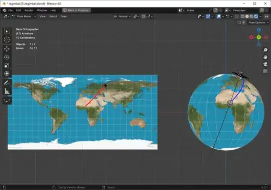

Let's say we're in Nigeria, and we want to get to Nepal. We break out an equirectangular map of the world, plot a straight line between them, and then we fly that path. But we find that we keep turning to our left during the flight. And at the end, we've used more fuel that we ought to have:
It's a straight line on our equirectangular map, which divides latitude and longitude into equally sized sections. This is just like Euler rotation about the Earth, which interpolates by dividing rotation in orthogonal axes into equally sized sections. We have a starting latitude and longitude; we have an ending latitude and longitude; we interpolate linearly between them. But because our equirectangular map is a distorted map of the Earth, a straight line on that map is not the same thing as a great circle about the center of the Earth. We're not following the great circle I'm showing as a halo around the Earth. We have torque.
The reason for this torque is that all of the latitude lines on our equirectangular map are the same length. But on the sphere, in reality, the latitude lines get shorter as we move away from the equator. If we interpolate latitude at the same rate that we interpolate longitude, we'll have torque. If we wanted to avoid torque, we'd have to adjust how we interpolated latitude, on the basis of longitude, or vice versa; we'd have to do so continuously, in order to get an exact great circle.
We don't have to be rotating about the Earth for this to happen. All 3D rotations describe paths along spheres. And no spheres can be mapped onto flat planes like this, not free of distortion. So all Euler rotations have this kind of torque. Euler rotational triplets work fine, right up until we interpolate them. When we interpolate them, we find that they're giving us rotations that are distorted in the exact same way that an equirectangular projection is a distortion of the surface of a sphere.
Importantly, notice that we haven't even rotated 90 degrees! Our starting position is pretty damn close to the rest pose of these bones. (My bones' rest positions are in world axes, and we're looking down the -Y axis. We're starting from Nigeria for convenience's sake, based on the Wikipedia image I downloaded to build this.) When we use Euler angles, we see torque with any rotation that exists in more than one axis. But, we'll see more torque as we get closer to the North Pole:
The lines of latitude don't change size at a constant rate. They get smaller, faster as we reach the poles-- the distortion on our 2D map increases as we travel further from the equator. So even though there's no special angle that this happens at, it's fine at the equator-- at a single axis of rotation!-- but it's really bad as we approach rotations of 90 degrees.
And this is why we want to use quaternions in certain situations. They don't create any such torque. Let's look at the same rotation, interpolated via quaternion, mostly because it will prepare us for the next trouble with Eulers:
Unlike the Euler plane, the plane that is navigating by quaternions describes a great circle. Its path isn't straight on our equirectangular map, but it follows the great circle on the globe. Our Euler navigator will see the quaternion navigator going a completely different direction, but arriving earlier, with more fuel. They'll look at their equirectangular map, dumbfounded how a curved path could be shorter than a straight path.
Problem #2: Aliasing.
"Aliasing" here doesn't mean jagged lines, just like "rendering artifacts" doesn't mean that you're suddenly getting the Hand of Vecna in your image sequence. Aliasing means that something goes by different names. Just like Jay Z is Shawn Carter and also HOV. It's just three different names for the same person.
Euler angles are the same way. Some rotation might go by different Euler "names". That is, there are different combinations of Eulers that can describe the exact same rotation. Like, this XYZ 180,0,0 misshapen monkey is in the exact same rotation as this XYZ 0,180,180 misshapen monkey:
One rotation, two different Euler aliases for it. And the axes of rotation seem to have blended together.
One fairly obvious place this happens is at the North Pole. On our globe, it's a point; on our flat map, it's a line. But this happens elsewhere as well. Let's look at how that might play out in our airplane, on the map of the world, by taking a longer trip:

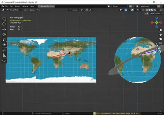

Now, we're flying all the way to Alaska. And you'll see that I used a second map of the world to describe our trip.
Think about latitude and longitude. Longitude goes all the way from -180 degrees to 180 degrees. But latitude only goes from -90 degrees to 90 degrees. After 90 degrees of rotation, it's like latitude and longitude become redundant, like they blur into each other. We could talk about being at lat/long 80,0. But we could just as easily describe that lat/long as 100, 180. And at the actual North Pole, we're at latitude 90, longitude anything! That's aliasing. We fix that, when talking about locations in the world, by limiting ourselves to latitudes in the -90,90 range, but in 3D, in Blender, we have a full 360 degrees of rotation for every axis; and for whatever reason, Blender doesn't simplify these aliases the same way we simplify the aliases of our latitude and longitude. And when we think about it, we're sending Eulers of any value: maybe -180,180, but maybe 720 degrees, or maybe 10,000 degrees. We could think of our map instead as an infinite, tiling plane of maps.
And look at what's happened to our two plane paths on the projection. Our Euler path is still a straight line, even though appears to cross the pole. But now our quaternion appears disconnected on our equirectangular map! Even though it's still a straight line, a great circle, on the sphere.
But if we look closely at that disconnect, we see that the two places are, in actuality, the exact same place. While it's flying over Greenland, it jumps from one map onto the other map, in the exact same location over Greenland. There are two different names we can call it, even disregarding Euler order. One instant, our driver reveals its YXZ rotation to be Y-32 X102 Z131. The next, Y141 X76 Z-42. These are very nearly the same rotations, just different by one single frame of travel.
Note what happens to the Euler plane. It flies onto a new tile, cross the North Pole. Why doesn't it fly straight on a single tile? Because of Blender's "anti-aliasing" which doesn't actually remove aliasing at all, it just picks an alias on the basis of a bit more context. Here, it decided it was better to fly onto a new tile than to explore the "canonical Euler" map that I already had. And note: even with a single order (these are all YXZ Eulers), there is more than one way to get from here to there.
If all you ever do to animate anything is enter numbers in XYZ rotation fields, you don't ever need to worry about aliasing. There may be multiple Euler triplets for a given orientation, but there are never multiple orientations for a given Euler triplet. And if you never rotate anything very far, then you don't have to worry about aliasing: just like on our map of the Earth, it only shows up when the rotations become large. (But, not at some particular number, not in Blender.)
But if you ever work with drivers or constraints, then you do have to worry about aliasing, because these typically work on orientations, not on raw Euler values. And so you see problems when you, say, copy rotation in only one or two axes, or without full influence, on a bone that's rotating far from rest. After a certain point, that rotation suddenly changes, just like our quaternion navigator's path seemed to suddenly change on our equirectangular map. And that will create sudden discontinuities in animation.
