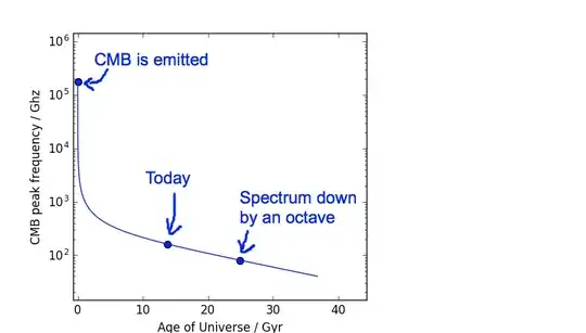

The wavelength of the CMB increases linearly with the scale factor $a$, which is defined as 1 today, so the "sound" of the CMB has dropped an octave when the Universe has doubled in size (in all three directions), i.e. when $a = 2$, which will happen when it is roughly 25 billion years old (see e.g. Fig 1 of Davis & Lineweaver 2004).
The magnitude of the dipole of the CMB is $3.4\,\mathrm{mK}$ (Kogut et al. 1993), i.e. $\sim10^{-3}$ of the peak value. The primordial fluctuations are even lower, roughly a factor $10^{-5}$ of the peak value. The dipole is partly due to our motion round the Milky Way, and so will fluctuate somewhat with the period of a Galactic year, which is 225 million years.
The figure shows how the peak frequency evolved in the past. Its current value is 160.4 Ghz. To calculate how a human would perceive the sound at a given time, I suppose you'll have to multiply the spectrum with the frequency-dependent transmission function of the human ear, but that's physiology which I know nothing about.
CMBfreq
The figure was produced by calculating the frequency at a given time as $$ \nu(t) = \frac{160.4\,\mathrm{GHz}}{a}, $$ where $a$ runs from $1/1100$ to $4$, and calculating the age by integrating the Friedmann equation, assuming a Planck 2015 cosmology.

  • Wow, very helpful and intriguing. I've corrected the formula above. – Alec Jul 08 '16 at 14:46
  • @Alec: Okay, I removed the part about the wrong value, and edited to plot to go a bit into the future. – pela Jul 08 '16 at 14:53
  • Thank you! The points are very helpful :) Do you know the frequency value at the first point where CMB is emitted? – Alec Jul 08 '16 at 14:56
    @Alec: You're welcome :). The CMB was emitted at redshift z = 1100, i.e. when the scale factor was a = 1/(1+z) = 0.0009, so according to the equation given, the frequency was 160.4 GHz / 0.0009 ~ 180,000 GHz. Note that if the spectrum is expressed as a function of wavelength, the peak wavelength doesn't correspond to the peak frequency, since spectra are expressed per unit wavelength or frequency bin. – pela Jul 08 '16 at 15:04
